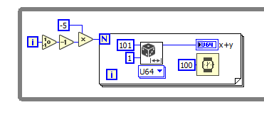

@altenbach wrote:
Since a FOR loop that iterates zero times basically does not do anything new, here's another silly solution; 🙂
(Also, there is a +1 primitive that you don't even need if you would adjust the random range accordingly. "x+y" is not a useful label, there needs to be a way to stop the while loop. The while loop probably also needs some timing, etc.)

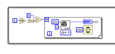

And if you don't like red (coercion dots) and green (booleans), one could do as follows: (still silly!!!)

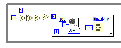

Or even ...

What I'm not understanding is the Poly instance.   Am I really missing something?  Isn't there a U8 instance?
Message 13 of 14
(1,590 Views)
No, only U64, I64, and DBL.
(Also note that there are bugs!)
Ideally, this should be a VIM where the output adapts to the input representation of the lower and upper limit. 😄
