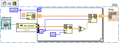

I think you are doing it way to complicated.
Try this:
NOTE: My local variable is somehow **bleep**ed. The reference control together with the property node should be a local variable.
Use the Code Capture Tool, it is so much better than the built-in LabVIEW snippet menu choice.  It doesn't break locals and references.

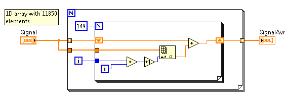

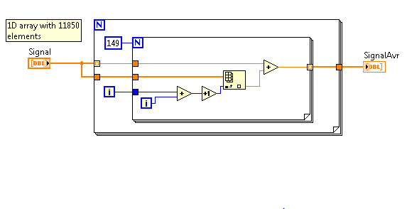

Looks like you guys beat me to it, but I will post my solution anyways.SigAvr.PNG
***EDIT: I need a shift register in the inner loop and should be autoindexing on the outer loop****
That solution will not work.  For that method, you need a shift register in the inner loop and you should be autoindexing on the outer loop.
