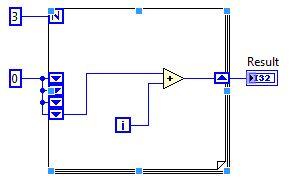

How can I create shift registers at left side of for loop  in count of 4 and at right side of for loop in count of 1 as in the image attached here. Thanks in advance!for loop.jpg

You can have multiple Shift register at right side, but extending of same **bleep** register is not possible at right side, only left side shift register can be extended to get mutiple iterated value.
Whats the need for having extended shift register at right hand side?

  1. Basically shift registers stores the values from the previous iterations.
  2. Place a For loop and righ click on the loop you can find Add shift register from the sub menu.
  3. Like in image that is called stacked shift registers, again right click on the shift register from sub menu you  can find add element.
