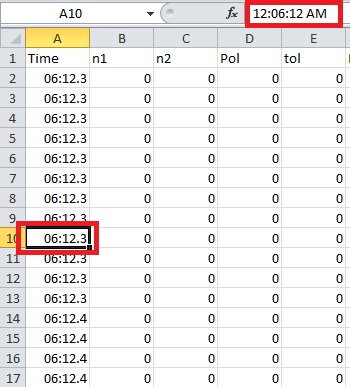

I have a csv file with first Column is time stamp. but i can't read in labview because Labview don't support.
The information as the attachment. Please help me read value in the first Column to time as red area on Fx.

Thanks for your reply. But string result is diffirent real value.
For example, when input string is: 6:12.3, output is: 7:06:12.300 but real value is 12:06:12 AM (as information on #1)

Then have LabVIEW that creates a format for the time that works for you.  Right now you are only output minutes and seconds, it appears.  That is all that is in your file.
if 6:12.3 is supposed to be 7:06:12.3, what did you do with the hour?  You didn't write it out to the file.
Show the VI you used to create the CSV file.  Until you get that correct, there is no way you are going to get Excel or another LabVIEW VI to be able to read the file the way you want it to.
