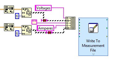

I have two 2d arrays which I want to save to en excel file. Till now I have simply implemented this by using write to measurement file function without any problem. Unfortunately the two 2d arrays are just next to each other, no empty cells in between to divide the two arrays. As well i'd like to put a header above each 2d array. Just something like below:
Voltages:
5 4 2 8 3
7 0 2 5 1
6 8 2 3 3
Amperes:
1 2 3 5 2
7 9 4 2 5
2 1 1 6 3
Any help, ideas or example vi's are welcome!

I was wondering if it is possible to fix this by putting everything in one big 2d array and inserting an empty row in between. And of course two rows with the header for each array.
Does anybody know a trick to create 'empty' rows? I know its not the nicest way of programming but yea... Smiley Frustrated

Okay, have my big 2d array of strings with headers, data and empty rows now!
Last question is how to convert the array of strings to dynamic data so that I can wire the array to the write to measurement file function.
