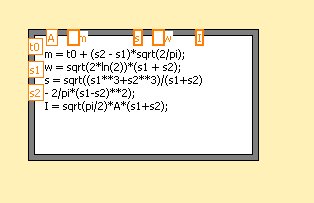

Formula Node output display bug
Here it is:

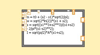

If I try to move the output sideways:
You can fix this problem by retyping the output variable names, for whatever reason.
Oh well...

How did you get these outputs to appear this way to begin with?
Message 2 of 13
(5,451 Views)
Don't know,  opened up the FP and here they were.

It was certainly there.  I believe you.  I just couldn't figure out how to make it happen to begin.  Wondering if you had a method to reproduce it.
It is weird.

I am not sure what you mean by your last statement.
But if you move the output themselves (which should force a redraw), the output is moved but the display glitch is still there. And in fact on my machine, moving the output "drops" copies of the variable name along the path:

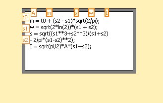

THAT is fixed by a "force redraw":
but as you can see, the variable names still won't fit into their designated frames.
The only fix I found was to retype the name (which oddly enough requires you to type this wherever the string happens to be - outside the frame):
