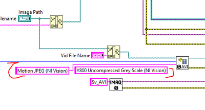

I am having a problem with dropping frame rates when saving Uncompressed AVI rather than MJPEG. Note, there is no problem when saving MJPEG @ 30fps, but the frame rate drops to approx 5fps if I wire in the 'Y800 Uncompressed' codec (see screenshot).

I'm now looking at the performance of the 'Y800 Uncompressed' vs 'Motion JPEG'. According to the following comparison, there should not be a significant performance drop (8ms plays 7ms write time). http://www.ni.com/example/30542/en/
Am I missing something obvious? Or is there an alternative to save the raw images for post-processing?
