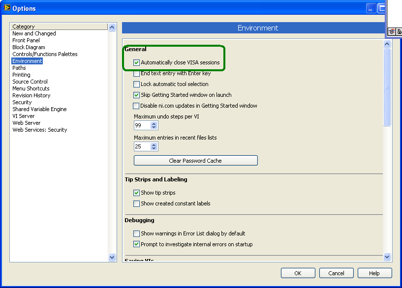

While Bill's method WILL WORK there is another easy way to accomplish this.
From Tools>Options select Automatically close VISA sessions.  With this set when a vi stops or is stopped any VISA resources are released
20637i6D5E02B1E6B0048F
20639iE8C1532B8F16C9BF
To demostrate the functional differance run the snippet above and attempt to open the same com port with hyperterminal.  With the option set and the VI Paused at the break hypertermnal will report the resource is in use.  Aborting the vi releases the resouce just as if the VISA close executed.  Uncheck the option and the behavior reverts back to holding the resource open untill the close function does run.
