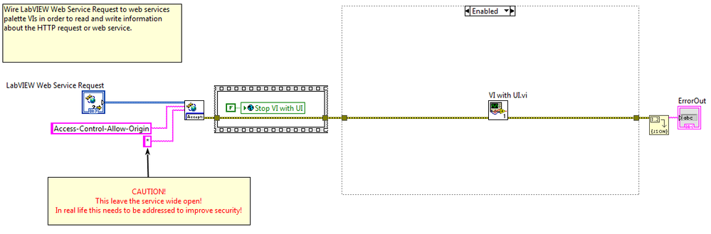

I'm trying to call a VI that would show it's front panel by a labview webservice.
It works on a debug web server, but it doesn't work when I publish the webservice.
Here is an example:

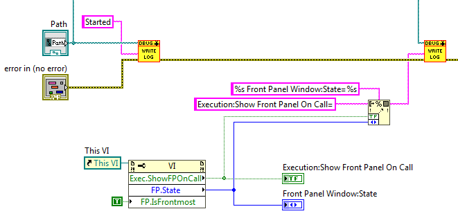

When "VI with UI.vi" is running it writes to a log file that it's "Execution:Show Front Panel On Call"  is True and "Front Panel Window:State" is Standard. So, it thinks, that front panel should be shown and that it is shown.

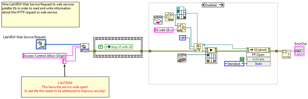

Even if I load "VI with UI.vi" dynamically and tell it explicitly to show it's front panel it behaves the same.
