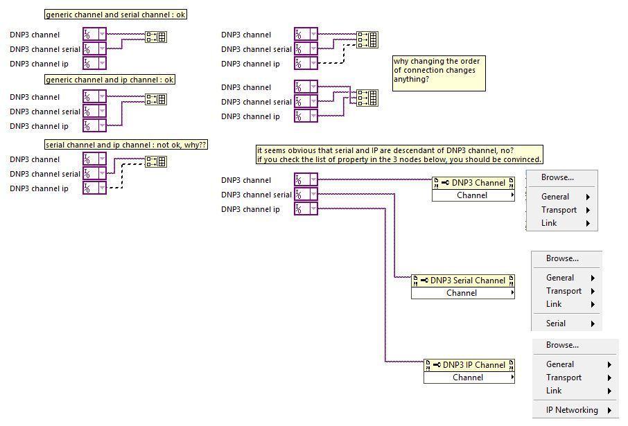

I'm sure there is a very good explanation for this, but why the order in which I connect "things" to a build array primitive would make it have or not have a broken wire?
You read well!
Drop a build array primitive
Enlarge it so it has 3 inputs
connect A to the first input
connect B to the second input
connect C to the third input
It works...
It should work as long the data type of A, B and C have a common ancestor, right?
Well now remove all the wires
connect C to the first input
connect A to the second input
connect B to the third input
there is a broken wire for B
A, B and C haven't changed.

When there is no broken wire, type is DNP3 Channel, the generic one.
For all I do I have a work-around for this issue.
With this type of ref there is some class inheritance somewhere but we don't have primitives to cast to more specific or to more generic like we do with VIServer refs.
Maybe it's an issue in the way DNP3 channel refs where implemented and maybe it's a more generic issue in the way LabVIEW handles inheritance with thy ref type.

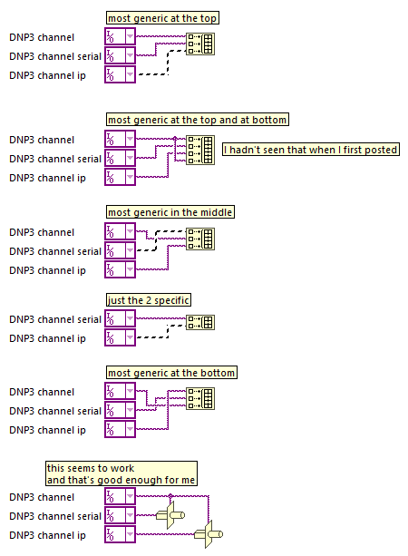

I thought it would be the case but either I misunderstand what you said or it's not the case anymore with LabVIEW 2018, because the buikd array is smart enough to automatically cast to more generic the correct inputs whatever the order :
And in the case of DNP3 Channel refs, it is when the most generic type is connected to the first input that there is a broken wire for one of the more specific type.
And when the most generic is at the end it works... maybe this is specific to how the DNP3 resource file was made.

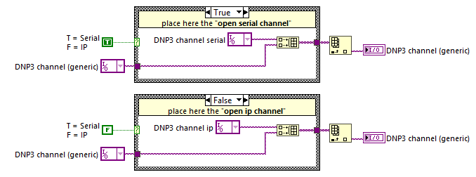

What I'd like to do in my App is to open the DNP3 channel - wether it is Serial or IP - in a case strutcure and output a generic DNP3 channel ref.
Is the build array with a generic ref and then index array the best alternative?
