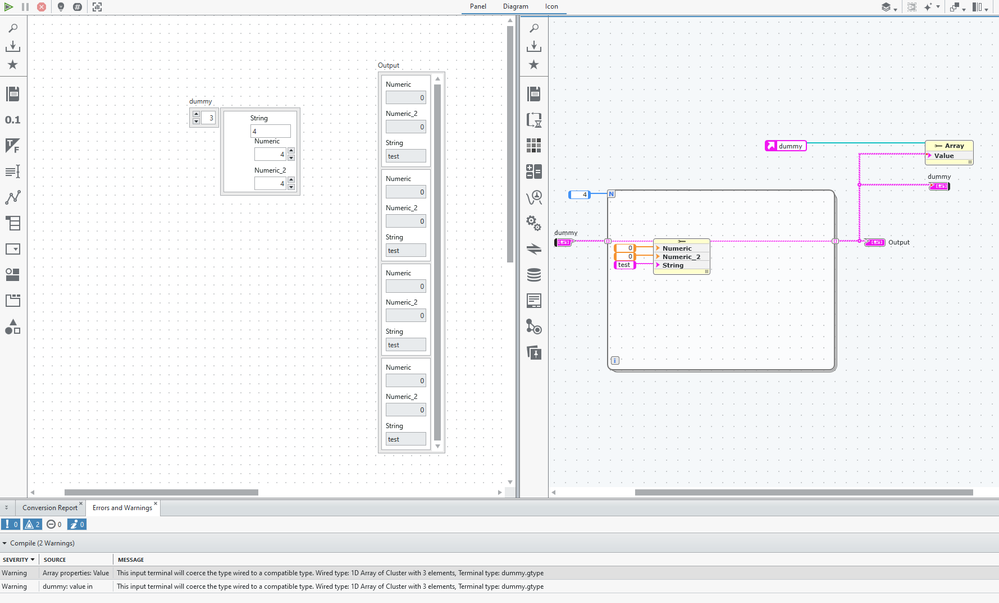

I have created a simplified example with a gtype called dummy consisting of an array holding a cluster with 3 control elements.
I can display the output using a new indicator called output. But if I use a duplicated terminal or use a reference + property node, I get a type error.

It is expected and you will see the behavior in both LabVIEW 2019 and LabVIEW NXG 4.0. When LabVIEW auto-indexes an array in a loop, it is not casting to a specific Array TypeDef. Usually, the type definition will be the element of the array (the data type of the array) not the array itself.
Read more here: How to initialize typedef array without loosing the typedef

Thanks for your help. I haven't included the array in my gtype and everything works now.
The type cast vi is complaining as soon as I connect a gtype to its type input. I get the error "Polymorphic terminal cannot accept this data type. Wired type: dummy.gtype"
