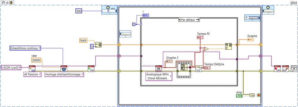

To illustrate and verify this phenomenon I made a VI that compares the time from the DAQmx waveform and PC time :

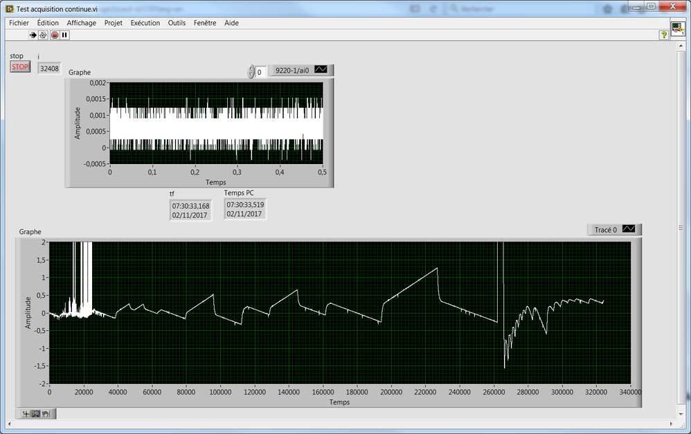

We see that there may be a gap of more than one second over 24 hours of execution :Acquisition continue_Capture.PNG

Hi CHI,
replace the TimedWhileLoop by a simple While loop. Then wire a sample count for the DAQmxRead function, I suggest 10000 as right now you have set the TWL to iterate at 500ms.
Let DAQmx do the timing of the loop!
DAQmx devices (most often) have their own clock. (You use this clock when you set a sample rate.) The timestamp youget from DAQmx is basically start time (t0) ot the DAQmx task with added sample number times sample interval (dt).
Remember: even then you might get small deviations between DAQmx clock and PC time: both clocks have their inaccuracies! BUt DAQmx hardware clock most often is more accurate then PC clock or software loop timing…

You are also comparing when the data was actually taken vs when you happen to check the time (some time later after any data transfer, Windows stealing clock cycles, etc).

I agree with the previous replies that the DAQmx time will be better than the PC clock. Also check if your PC is synchronized with a time server which will adjust the PC time periodically.

It is my impression that when doing a continuous  acquisition, DAQmx gets the start time from the computer all other subsequent times reported in logging files are calculated from the sampling rate.
You can test the accuracy of your DAQmx clock by using a known frequency standard, check the FFT and its higher order harmonics. The higher frequencies are more susceptible to any clock inaccuracies. For example, assume you have a stable 10kHz frequency standard, look at the FFT of a long time acquisition. If you measure 10.001kHz on your DAQ you gets its accuracy.
