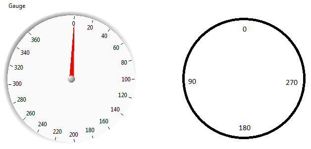

Hello all,
I need some pointer how to change the gauge number to something like the right picture. Thanks!!!
(3,849 Views)
Search for "custom guage" and or "compass" for more info.
YOu can use the drag tool to drag the max to overlap the min to get a full circle.
The numbers can be specified manually using property screen or using methods to do the same.
Ben
(3,836 Views)
Look at message 159 in the Micro-Nugget thread.
Lynn
(3,816 Views)
like ben said...rt click gauge and goto properties, scale tab and check "inverted", then goto text label and empty string on the 360 value to not appear.gauge_VI_FP.png
