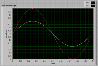

Here is an example to solve your third question. Merging two or more signals into one graph:
Block diagram                                                                                                                                Front panel

Q3. Even Deejay gave you one answer.  Look at the Help files for the graph.  They tell you how to connect multiple signals.  If you have been using LV for less than 30 years, it is a good idea to always keep the Context Help window open while programming.
