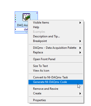

Any expert in DAQmx would recommend ditching the DAQ Assistant and using the DAQmx drivers to have better control over stuff and good learning.
This is a good article to learn the basic DAQmx APIs (skip the DAQ assistant part)
https://www.ni.com/en-us/support/documentation/supplemental/06/learn-10-functions-in-ni-daqmx-and-ha...
You can also convert your existing DAQ Assistant into equivalent DAQmx code by invoking "Generate NI-DAQmx code" in the right-click menu.

Dear Santhosh,
Thank you very much for the advice.
The link you provided is very helpful.
I will try to generate DAQmx code.
