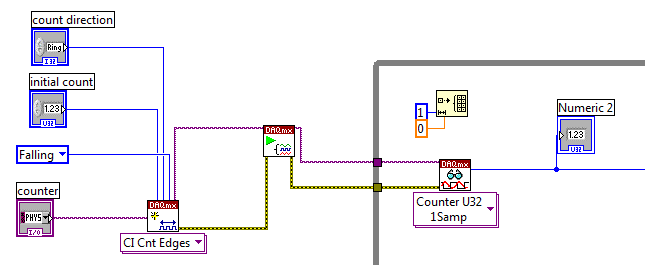

I have set up a counter so that when i apply an impulse signal to it, it counts up by 1.
I would like to have it so that everytime it recieves an input impulse and counts up by one, i want it to generate a 'logic high' for a short period then go back to 'low'
How would i go about doing this? I want this counter to essentially be my clock and initiate events everytime a count is recieved.

I want to take reading from sensors every time I detect a digital edge.
If I wanted to do this how would I do it without using the counter? I want it to continously detect a digital positive edges, take a reading then wait until the next digital high edge.

You're looking for triggering.  But, why add the extra component?  Trigger your reading from the external line

Is it possible through labview to acquire a sample of the signal on a high edge trigger then stop at a low edge and repeat?

Hey mikeboxes,
Here's a old-but-good example of how to do what you're asking:
http://digital.ni.com/public.nsf/allkb/BA775B0E445BFA79482571FE0032CCEB

Depending on exactly what you need to do, you have gotten a couple good ideas. In addition, if your cards supports it, you can also generate an event on a digital transition that will trigger an event structure in LabVIEW.
I believe that you can also trigger and clock timed structures from external sources.

ah yes, this is what I was looking for and is working for my application.
Thanks plenty!
