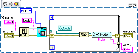

Try this, you can do similar searches for functions or structures or whatever.

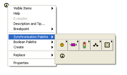

@nos wrote:
Thanks for your responses.
After an interval of not working on a vi I never find it easy to recall the palette location of all the functions used. To make this easier I was hoping for some utility within Labview that might show where all the functions in the vi are located.
For example, after a gap of a few weeks it is not obvious to me that the 'First call' function is located within the Synchronization palette, so some kind of tree, similar to the link provided by Ben, see http://www.dsautomation.com/doctool/ , documenting the functions in a vi would be useful.
nos
When I am working on a mahcine that does not have my Quick Drop Short cuts defined, I use the built in short cut for an operator when I need a function from the same palette. Even though I know which palette they are on, the sort cut reduce the milage on my old wrists. See below for the short cut from the First Call to the Syncronzation Palette.
19043i29CED628B8003B1D
Ben
