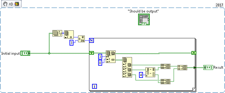

After working on it I realized that it does not repeat the initial input 3 times over.. my mistake. But some progress has been made!
I have a VI that is very very close to what I need as an output but im missing one crucial step in generating the array. I know insert into array should not be used but im trying to insert two deleted selections of the 24 bits per row array together then interweave this with the first 12 bits of the 24 bits per row array to generate the "desired output".
For some reason im missing 5 rows of the the initial input/desired output from my resulting array! This is where my problem lies why are they missing?
Thanks again for any help.
You need to be more specific. It does not help if you attach convoluted code that gives the wrong answer. Best would be if you would try it on the numeric array first as in my earlier example. Generate an appropriate input and tell us how the output should look like there.
Here is a little less convoluted way to get your desired output (at least for the first 10 rows). It also will scale for larger data sets. I'm sure there is a better way to do it. I just can't think right now how to build a better mousetrap.
I too have NO IDEA where the last 5 rows of data come from. The "initial Input" has 120 elements (15x8 array). If you reformat to 12 columns, you only get 10 rows (10x12 array has 120 elements). There is no more data to process unless you reuse/repeat some of the old data.

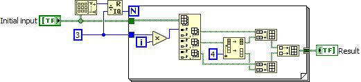

The main problem is that you constantly resize the array in the shift register for no good reason at all. This can be hard on the memory manager. If this is really the solution (and the number of rows is divisible by three), all we need is the following.

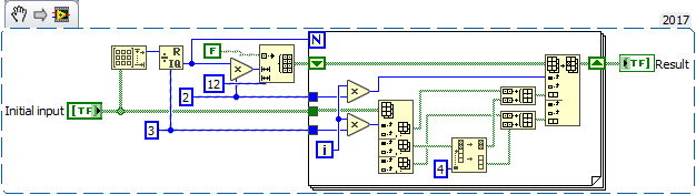

We can operate on the original array e.g. as follows, but yes, there are probably still better solutions. 😄

Also, while I hope that the compiler can make my above code operate in place with a single output allocation, I am not 100% sure, given the splitting, appending, and the concatenating tunnel.
To be sure that things are done efficiently, we can do the allocation of the output more explicitly. In this case it could look as follows.
