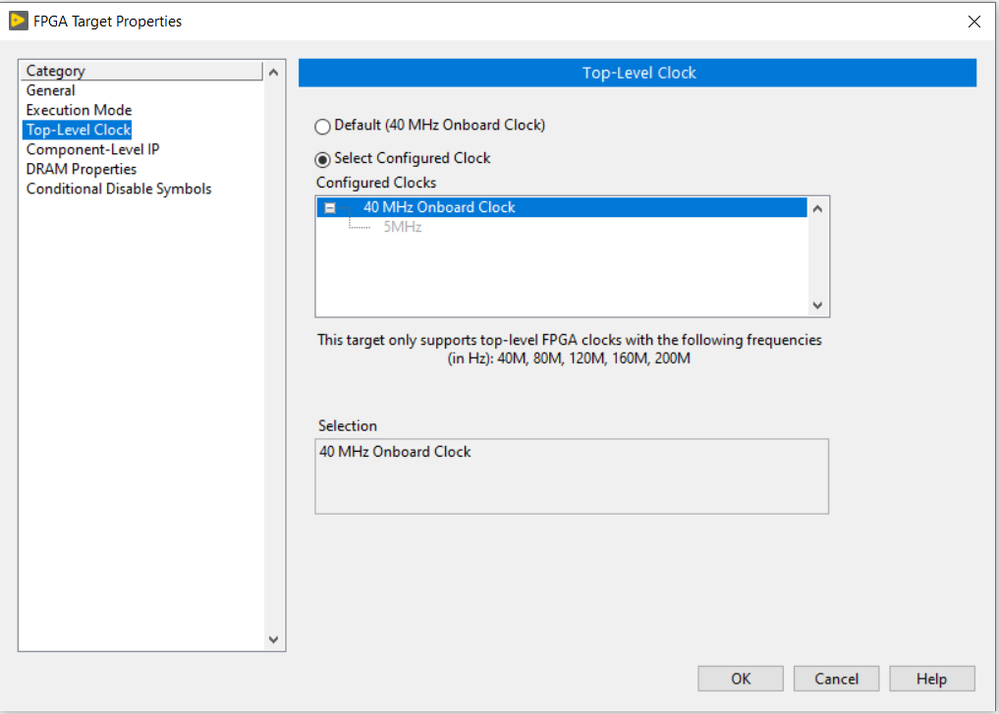

i Could not change the FPGA clock Under 40MHZ. can anyone help me .

Hi Emna,
you could create a derived clock from the FPGA base clock in your project - but this will only allow down to 4.69MHz for this cRIO type (tested with cRIO9066).
But you can create a SCTL in your FPGA VI, running at 40MHz. This SCTL can then switch a boolean flag each 50 iterations to create your 800kHz clock signal!
