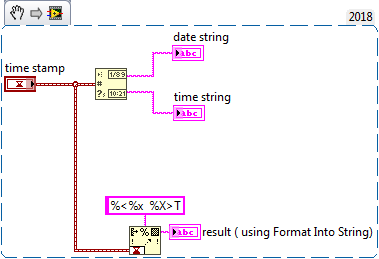

ok... has anyone seen this before?  I'm trying to set a date in the future... and when I convert it to a string, using the Get Date/Time String function, I'm getting a date of 1964.  I'm sure it is probably some issue relating to the date I'm choosing... but I'm trying to leave it as far out as possible.  Any suggestions?
I've included the base code showing this, in addition to a screen-shot of what I'm seeing.

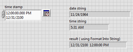

*NOTE: I did try using the different formats, and in every case, the time is way off and the date is 1964 (for an input date of 12/31/2100 12PM

It looks like 2/6/2040 12:28AM is the last date it will correctly interpret.

It works fine using Format Into String. I would think it's a bug in the Get Date/Time String

Looks like the Get Date/Time String.vi is converting the timestamp to a U32, the roll-back is happening after 01:28:15 Feb 05, 2040 (4294967295 seconds past Jan-01, 1904).
