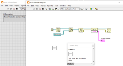

The Get Help Info is for the Detailed Help link to the compiled HTML help file.
The text in the context help is from the VI Properties >> Documentation. Use VI Description property to access it.

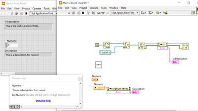

Thanks for the quick reply. Is it possible to get the help text for other native LabVIEW nodes, like string controls, and not the Sub Vis alone?
(1,541 Views)
Accepted by topic author Kaiser_Asan
Similarly, use a property node to access Description property but wire the reference of the control instead.
