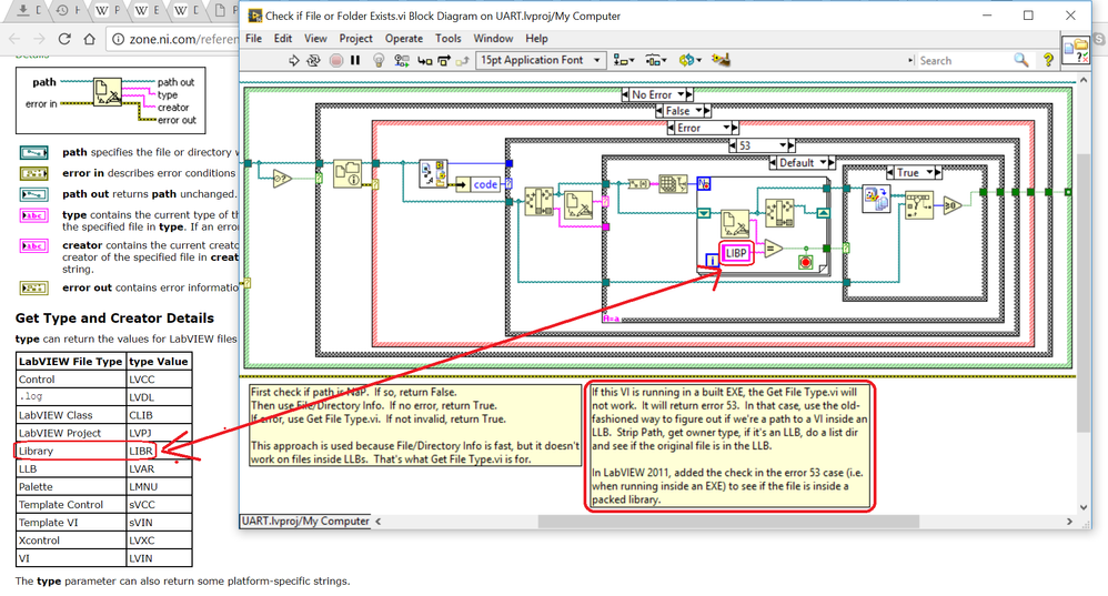

I got confused with the information provided inside the VI "C:\Program Files (x86)\National Instruments\LabVIEW 2016\vi.lib\Utility\libraryn.llb\Check if File or Folder Exists.vi".
In that, there is a condition checking for Type = LIBP, but when I referred to the Detailed Help for the VI "Get Type and Creator" to understand what this LIBP means, I could not find it there. The closest thing I could find is LIBR, which means a LabVIEW Library it seems...
Could someone shed some more light on these File Types, or let me know if I'm missing something very basic?! What does LIBP mean??

Hi parthabe,
from the comment I would guess it's the shortcut for "packed library"…

*.libp is for the Packed Project Library (LIBrary Packed).
Why is it not in the help?  Well, I would say you just found a bug.
