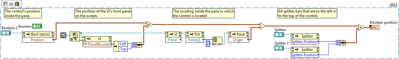

you are indeed correct. If you happen to have multiple panels with splitters, the you have to account for the splitter positions as well, assuming they are to the left, or on top of your control. Here's some very simple code written for your example:
Of course to make it more flexible for any setup, you will need to add some tuning to that (you can programmatically get the right pane instead indexing with Owning property, check splitter Vertical? property to decide which coordinate to add to, check whether to include splitter based on position and other things I've been too lazy to properly code Smiley Happy), but this is the basic idea.

I didn't have time to test this until now. I have an additional question, how do you know which splitters to add? Some of them can be below or right to the control and they shouldn't be added.
