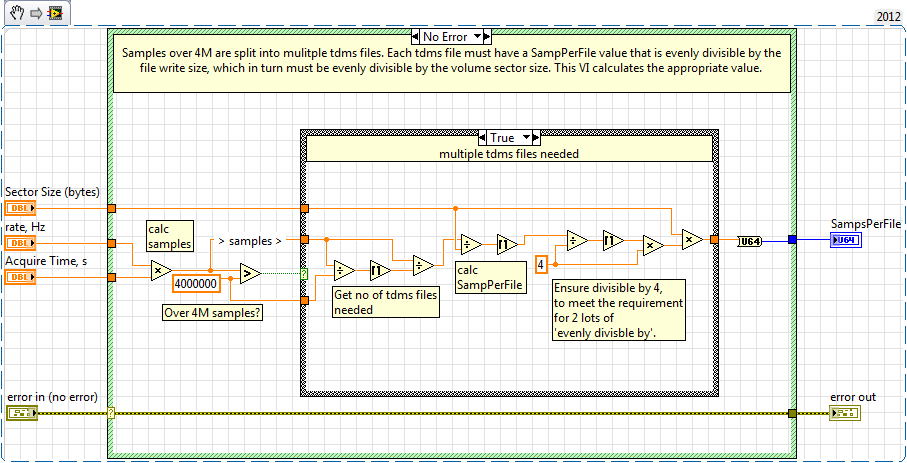

Thank you for your help.
The Get Volume Info does indeed give me the Sector Size, however i still had problems with working out what multiple of the sector size to use.
Based on "Samples per file - must be EVENLY divisible by the file write size" and "File write size - must be EVENLY divisible by the sector size" I have derived te following code snippet which ensures that the calculated SampPerFile is divisible by 4 (2 lots of evenly divisble by).
Whilst this appears to work I wonder if anyone could comment/ suggest any pitfalls etc.
Helen
CLD, CTD
Message 3 of 11
(6,511 Views)
Um, code fell over, I got the same error : requested SampsPerFile 3833856; suggested SampsPerFile 4376064 for Sampling Rate of 1M and AcquireTime of 45.
Do I also need to specify Logging.FileWriteSize and if so what are suitable values to use (other than being divisible by the file sector size)?
Hoping that someone can help me here, thanks.

The file opened in LV2012 fine, however it fell over with: Acquisition of 8 seconds, No if files  = 2, Acq rate 1M with the
error -201383,
Possible reason(s):
The file write size specified is too large. Performance can suffer if the file write size is larger than one-fourth the size of the buffer length.
Task Name: _unnamedTask<4>
Input buffer increased to 16001000 with File Write at 4000260.
I noticed a bug in my original code and fixed this, so my code is working for the inputs that i currently need, however i think that i need to change the maximum samples per file permissible from 4M. Do you know what the maximum size is? I only want to split into more than one file if the data per channel is over this maximum limit.
