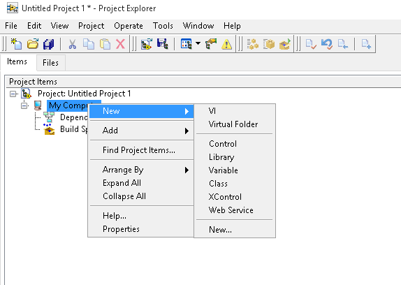

I am new to NI labview. I am trying to learn to use it for my project in college. I am trying to connect softmotion mudule and solidworks motion with labview. But I have been stuck at the very beginning. When i right click at Project>> My Computer>> New>, I don't find any option for solidworks assembly. I know its a silly queston to ask, but please help me. I have tried on computers of my other friends too but I am having same problem. I am using Labview 14, Solidworks 2015 and LabVIEWSoftMotionModule2014f1. It would be a great help if I get to get started. Thank you for your help. This is how it looks like at my labview. There's no option for solidworks assembly.

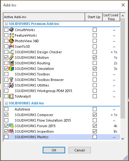

About that add-ins, I have already checked those. I guess this is what you were asking me to do right?

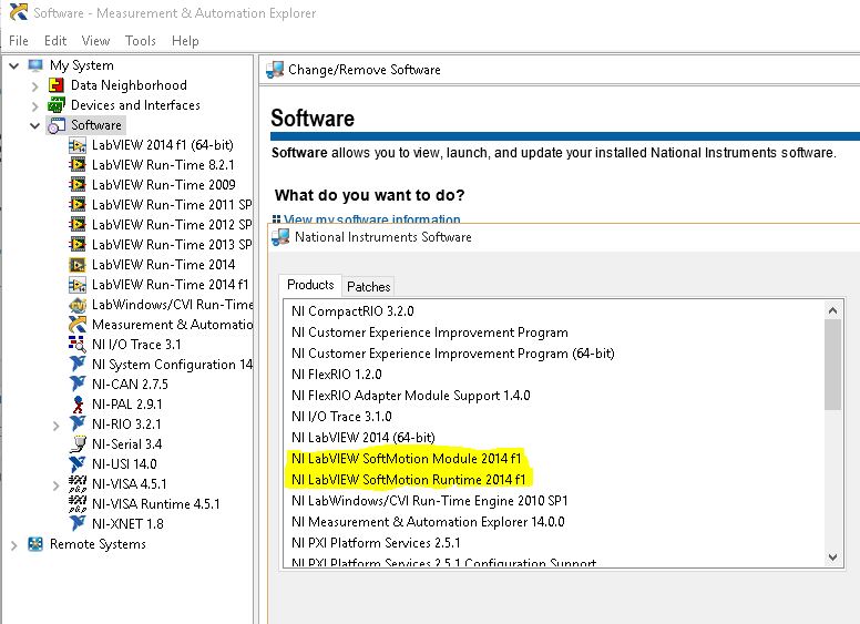

When I go to Tools>> Measurement and Automation Explorer>> Software>> Change/remove software, I see Softmotion

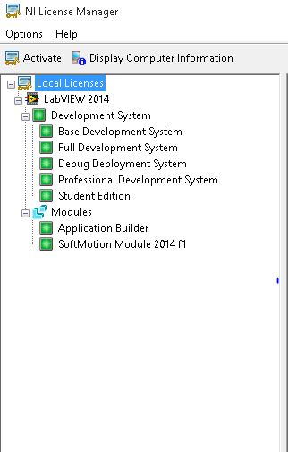

And yes upon opening NI Licence Manager, under module, Softmotion Module 2014 f1is listedlicense manager.JPG

Like most LabVIEW modules, SoftMotion only supports the 32-bit version of LabVIEW. You will need to install 32-bit LabVIEW 2014, then reinstall SoftMotion 2014 f1 to add support.
