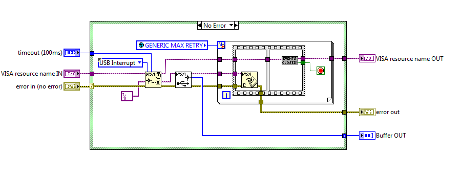

I'm developing a subVI in LabVIEW 2012 SP1 32-bit which takes advantage of VISA USB RAW. I currently have VISA 5.4 installed and I'm running Windows 7 64-bit. Essentially, I'm reading interrupt transfers from a USB HID device. Below is a screenshot of my subVI:
Most of the time it works without a hitch, but once in a while I will get the following error:
Error -1073807315 VISA:  (Hex 0xBFFF002D) The event queue for the specified type has overflowed. This is usually due to previous events not having been closed.
It always occurs at "VISA Wait on Event". While debugging, I have the front panel of this subVI open so I can see that "error in" is not passing in a previous error. As you can see in the screenshot of my block diagram, there isn't much there and I am in fact closing the event reference when I'm done with them. The only thing I can think of is that the previous Event Queues are not being closed fast enough. It may sound like to workaround it I may need to first check for any open Event Queues.

When I initialize the USB RAW VISA session, I set "Maximum Queue Length" to 1 (why I do this is kind of a long story, but I'll explain if it deems necessary). According to the LabVIEW documentation, VISA should automatically discard any new events once the Event Queue has been filled. I have never had a problem with events being automatically discarded due to a full event queue. Also, I used to get this error after this subVI executes many, many times. So in this case, I didn't think using "VISA Discard Events" would really accomplish anything as the queue get filled immediately and VISA should be discarding everything else until I consume the single event in the buffer (more on that later). I did some testing and confirmed that this error occurs when I try to use "VISA Wait on Event"  without closing the event references more times than "Maximum Queue Length". So, I edited my sub VI to the following:
What the code in the For Loop is supposed to accomplish is attempt to close the event reference, then check to see if any event references associated with this particular VISA session are still open. If not, it will set the For Loop conditional to TRUE to stop the loop. Otherwise, it will continue to another iteration of the loop where it re-tries to close the event reference up to "GENERIC MAX RETRY" times (set to 3 in this case). This edit to the subVI dramatically helps, but I still run into some cases of getting this error even though there are no open event references.
I did some other testing where I take my subVI and put it into a For Loop and set N to 500. I notice the same problems where at least one time in the 500 loops, I get the same error even though no open event references exits. So it looks like it is related to executing the subVI too quickly. Therefore, I tried your advice and placed "VISA Discard Events" immediately afterwards and the problem no longer exists! Even when I loop 1000 times in a row!

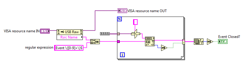

If your curious about how exactly I confirm event references exist, below is the block diagram of the subVI which you in the second frame of the Flat Frame Structure:
The subVI with the icon: visasessionssubVI.PNG is "Open Sessions.vi" taken from "visa.llb" that is included with LabVIEW. It lists all open VISA sessions.
