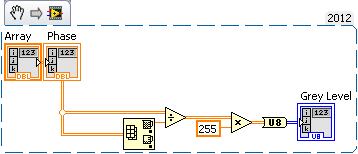

Hi Enriquez,
I guess I misunderstood your intention;
now I think I understand what you want to do:
Alex

Hi Enriquez,
wow, this is quite ... creative.
Obviously, you want to plot "phase" as a function of "grey level" e.g. y_phase value = f(x_greylevel).
For which row or column of the phase array and the corresponding greylevel array?
Maybe, for all rows/columns?
Alex
