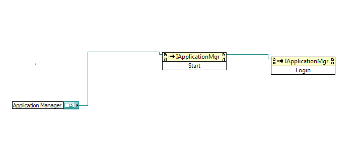

because after I run this I have this error:
Message 9 of 20
(5,695 Views)
That is the method I was thinking of.
I think someone else is going to have to help, I don't have Teststand right now, so I can't try out anything myself and I'm just going from memory, not easy to remember the order of things etc.
Can I suggest again going to look at the shipping examples of LV user interfaces? I posted about it earlier. They are a great starting point and reference for what methods to use and how to link things together.
