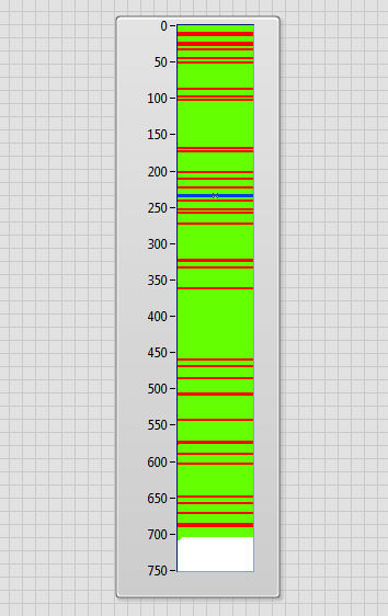

I have a simple scatter plot on a graph that includes all y values with a single x value of zero trying to make an easy to use viewing tool as an add on to another control.  The graph plot is too small in width for what I want to accomplish here.  Is there a better way of making it look like a more fat stacked bar than this?

You might try the following:
(1) Change the X scale from 0 to 2 (instead of centering)
(2) Change the "Common plots" back to default (upper left)
(3) Change to horizontal bar plot filled (bottom middle) from "Bar plots"
(4) Change "Base fill line" to +infinity
Results:
Is this better?
(2,588 Views)
Yes Sir, Thanks A lot
