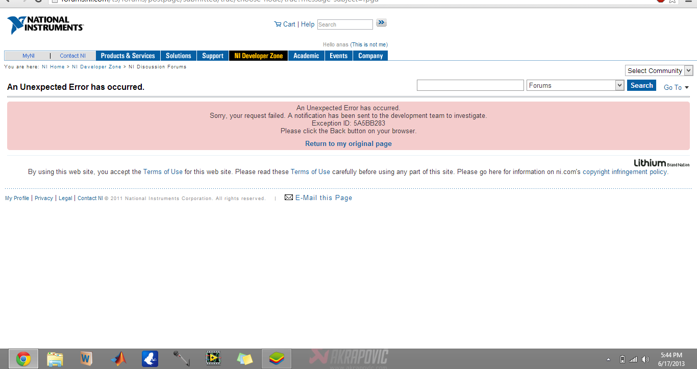

Dear REDS,
I'm facing this terrible issue of posting any question to any discussion board over here. When I hit the POST button i get an error as shown below. Untitled.png
I mailed to NI but haven't got any reply yet. I just could not find any other way to share this issue. I need help

Hello NapDynamite,
That is a strange behavior I haven’t seen before. Have you tried logging in, logging out and logging back in again? Maybe also try using another web browser, like Internet Explorer or Firefox.
I will ping the department in charge of this on our end so that they can help you.
