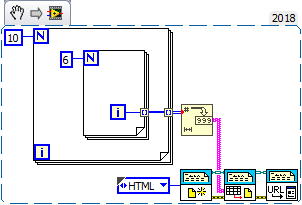

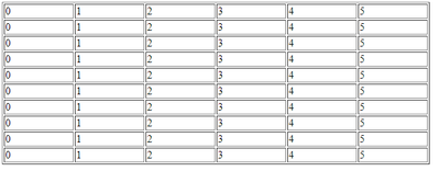

My predecessor made HTML reports that printed very nicely with tables that had single-lines.  Running this in LabVIEW 2018 (SP1 on Win7) gives me these hideous double-lines and I cannot stand it.
Here's a simple example:
Here's the code that made it:
I don't have any older versions to test if this is a version issue.  I don't know what our IT overlords have done to my computer so I can't say if it's an OS issue.  Have you seen this?  What do I do to create a table with simple, single lines?

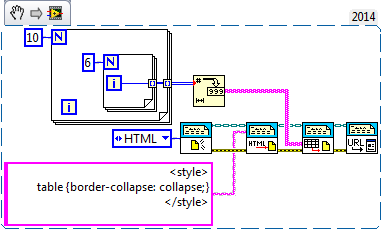

This helps, but I'd be surprised to know it's needed.

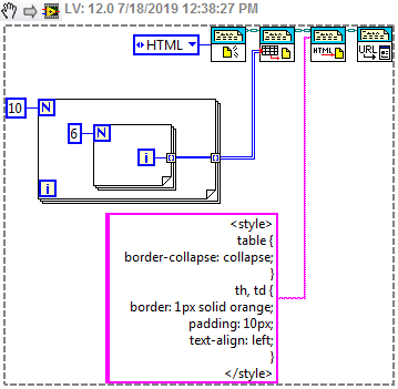

With your code, I get the same look.  However you can embed a style tag into the report.
aputman
Message 4 of 9
(4,012 Views)
BTW, I tried in LabVIEW 2012. Doesn't seem to be a version difference.

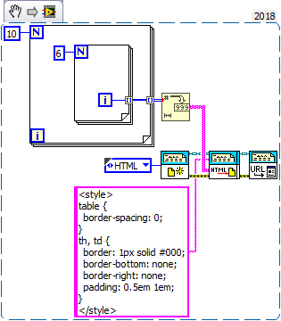

Thanks, guys.  I went with the following because the text blew up, too):
Bonus points if you can tell me why it happened, and if this "fix" is likely to break the app on other operating systems.
