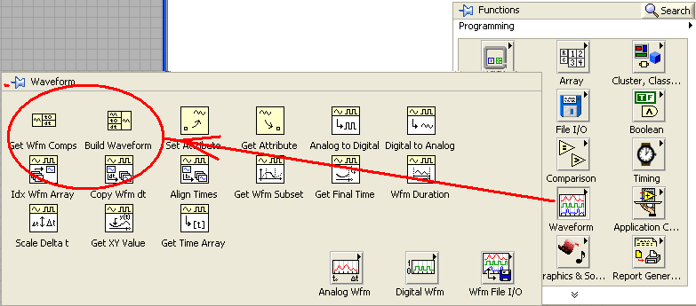

Have trouble increment
It's in the Waveform section of the Functions Palette.  See image below:
[EDIT_PORTION_START]
Oppss.. Wooohhh..  That was weird..
I submit and see the image right away...
Guess smercurio beat me to the post..
Oh well.. here's my picture... same place..
[EDIT_PORTION_END]
Message Edited by JoeLabView on 06-17-2008 12:02 PM
