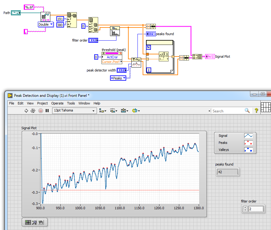

I am a new Labview user and having issues in finding the exact location of the peaks. I tried modifying the example of peak detection vi as per my requirement but couldn't figure out two issues,
1) the x-axis of the plot should be 900 to 1300 but showing 0 to 400.
2) Giving the wrong peak locations.
Your help will be greatly appreciated.
You are creating a new x axis, starting from zero: so why do you wonder about this behaviour?
It is giving the correct peak locations as described in the LabVIEW help: as sample index in the sample array!
You need to convert those indices back to your x locations using the x axis from your CSV file!

1) I got your point. The for loop shouldn't be there.
2) What is the formula to convert sample indices back to x location.
Thank you.
You can use options:
  • Use IndexArray with peak location as index into your X values array.
  • Use Interpolate1DArray with peak location as index into your X values array…

I am still struggling to get the right peak locations. I understand what you meant but unfortunately couldn't do it in Labview. Can you please add these bits "
  • Use Interpolate1DArray with peak location as index into your X values array"
 to get the desired peak locations?
Did you even try to use one of those options? Why don't you show what you have tried?
Message 7 of 11
(3,420 Views)
You have the "Locations" values as an array of DBLs.
Copying from the already mentioned help:
Locations contains the index locations of all peaks or valleys detected in the current block of data. Because the peak detection algorithm uses a quadratic fit to find the peaks, it actually interpolates between the data points. Therefore, the indexes are not integers. In other words, the peaks found are not necessarily actual points in the input data but may be at fractions of an index and at amplitudes not found in the input array.
If you want to get the value of the X array given an X index, you can either
  1. Use Index Array. This requires an integer value - you could consider using Round to Nearest (or Round towards -Inf, if you're concerned about an out-of-bounds access)
  2. Use Interpolate 1D Array - the help file can provide more details, but given you have an array of X values and an X index, it should be simple enough to work out how to wire this function to provide an interpolated X value.
Note that for both of these solutions, you'll probably need to provide a For loop to go through your list of locations. Take care not to allow indexing of the X array at the input tunnel.

Hi GerdW.
Thank you so much for doing it.
I wasn't disabling the index of the For loop.

I was making the mistake you mentioned at the very end of your comment. Thank you very much for your detailed help.
