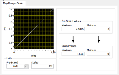

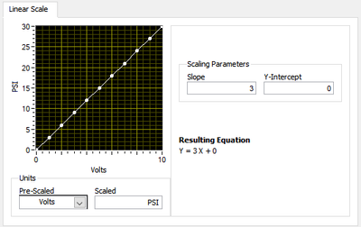

Well, you have a 0-5V input and a 0-15 PSI output.  That equates to a slope of 3 (rise over run).  Obviously, those are ideal values and not what your sensor will output.
You can use the Map Ranges scale to enter the calibrated 0 value and the calibrated max value of your sensor.  Use Ohm's law to convert the milliamp value to volts.

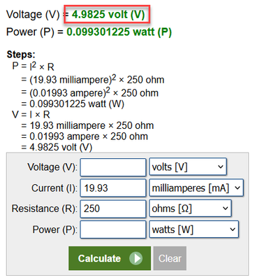

So let's say your calibration report says that 19.93 mA = 14.98 PSI.
Plug 19.93 mA into an Ohm's law calculator with a 250 ohm resistor value and you'll get 4.9825 V.
Enter that into your scale for the maximum value.  Do the same steps for the minimum value.

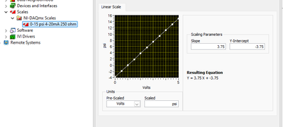

It's important to remember when converting a current loop transducer to a voltage input (typically via a 249 ohm 1% resistor), that your 0-15 psi functional range DOES NOT map to 0-5Vdc, it maps to 1-5Vdc.  Current loop solves two very old, real world problems: 1) it reduces noise pickup on long wiring runs, and 2) it provides an automatic off-scale indication for an open wiring fault (0 mA is NOT a valid value, ever).
Unlike what was posted elsewhere, your idealized mapping is not 3.0 psi per volt, it's 3.75 psi per volt, and you have a (-)3.75 psi offset, as shown below.  If your current loop is disconnected, you'll properly get a negative pressure reading, which you should flag as a fault.
Hope this helps!  Best regards,
Dave
(Note that in the MAX custom scale dialog, you can edit the sample graph X-axis values as an easy way to visualize that your slope/intercept values are correct.  Here I'm showing 0-5V, but you can change the scaling to 1-5V.)
