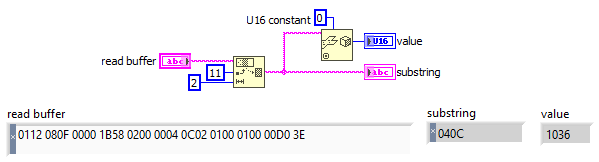

Try this:
______________________________________________________________
Have a pleasant day and be sure to learn Python for success and prosperity.

forgot to attach the vi, here it is

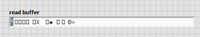

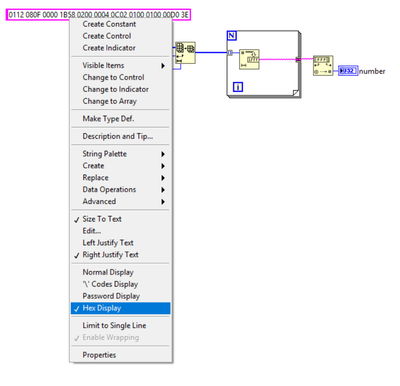

for string controls you can view bytes as nonsense, byte strings, passwords? or Hex by right clicking the string control and selecting an option (see below).
Which is why you should make the display type visible if it isn't the default display type.

@billko wrote:
Yes ... if you look very closely you can see the "n" for nonsense ; )

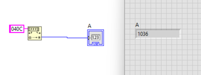

When I enter 040C as a constant, I’m able to convert it to decimal (040C = 1036):

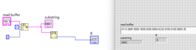

but when I extract 040C from my frame (0112 080F 0000 1B58 0200 0004 0C02 0100 0100 00D0 3E), I don’t get the correct conversion (I get 0).

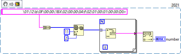

@Fredo123Danzel wrote:
I would like to extract 040C from my frame and convert it to decimal (040C = 1036). Your script extracts 4C from the frame (4C = 76). Maybe I didn’t express myself clearly.
You have a binate string and this has nothing to do with hex formatting.
You need to typecast or unflatten it to your required datatype (U16 or I16). You get 1036 if you assume big endian.
