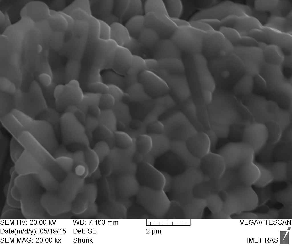

Hi guys. Please help calculate the area of round shapes and elongated rods.
Please help calculate the area of round shapes and image-23379M616.jpgimage-23379M612.jpgelongated rods.

Round shapes: A = pi . r^2 (approximate as circles)
Rods: A = L . W (approximate as rectangles)

Or just count the number of pixels comprising the desired shape. (I assume you can identify the outline of the areas of interest by some algorithm).
Since the image is quantized to pixels, you won't get much more accurate than that.

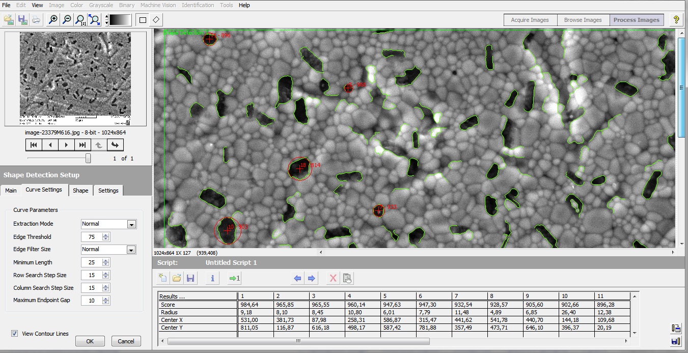

Have a look at the NI Vision software, or the open source "ImageJ" application (I used both for similar tasks during my PhD and they work nice + easy learning curve).

In order to use the formulas, you need to fit the relevant image parts to a 2D model that contains the desired parameters. It also assumes that the areas are perfect circles or perfect rods, which does not seem to be the case. I think counting pixels as suggested is sufficient. To get the actual area, you need to know the area/pixel.

Here's a very simple draft how you could calculate the area percentange of pixels that are darker than a certain threshold. Maybe it can give you some ideas.
