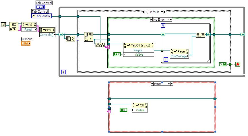

Attached is a simple VI that will iteratively search for controls and when one is found, set its visable property true. Change the "This VI" constant to a path control if you want to use this VI on other VI's.
Most of its opeartion is self explanatory except the "to more specific" function that is used in a manner I first saw demonstrated by Jean-Pierrre Drolet. If LV is succesful in converting the control reference into a tab control reference, it assumed to be one. In that specail case, we gather a new set of control references and add them to the pile.
the process continues until we can not find any more controls to make visable.

...to make a slight addition to Ben's example, don't forget to recurse through Clusters and Arrays (the other control types that can contain other controls) in addition to Tab Controls.  And in case you're wondering, yes, you can make the element inside an array invisible... 😉
...and in case you're still wondering, RadioButtonsControl inherits from Cluster, so you don't have to parse those separately from Clusters.
...and in case you've stopped wondering, I'm thinking about officially adding a panel parsing VI to vi.lib somewhere in a future LabVIEW release so you guys can stop writing your own...if you own the VI Analyzer, you've already got one:  vi.lib\addons\analyzer\_analyzerutils.llb\VIAnUtil Get All FP References.vi.

Aside from the method I used in my example I have only seen scripting methods used to ID control types. Do you have any recomendations on better ways of identifying what type of control a reference is associated with?
Ben
Message 9 of 52
(8,886 Views)
I made this suggestion in another thread recently...you can wire a control reference into vi.lib\utility\GetType.llb\Get Type of Control.vi, and it returns an enum describing the datatype of the control.  As for identifying controls based on their class, you can use the Class Name property of the Control class.
