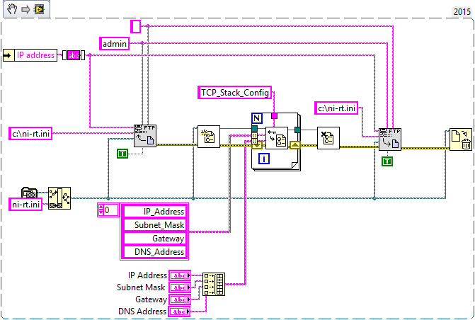

Accepted by topic author 314159ym
Have a snippet. I'm feeling generous.
This was to FTP a file out of the RIO to local PC, modify some settings and FTP back to the CRIO. Then delete local copy.
Assumes RIO FTP is set up with username = Admin, Password = "" which I think is the default on the VXworks RIOS.
0xDEAD
