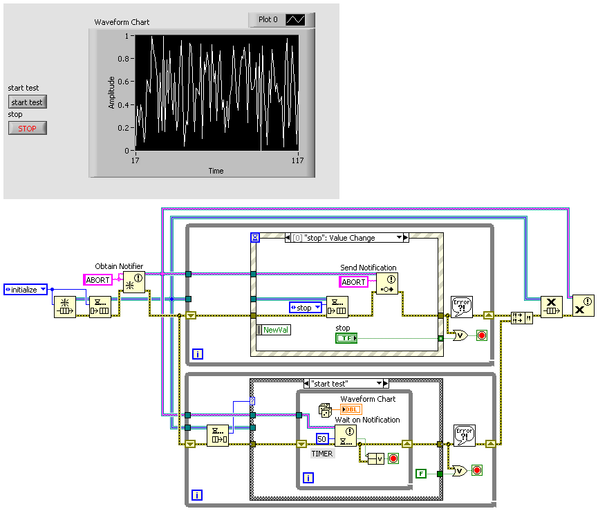

when i want to INSTANTLY EXIT a loop process, i use the "notifiers" and the "time out?" node inverse or'd connected to the stop, this will fire once the notification "ABORT" is sent and received....ABORT NOTIFIER.png

Weird anomaly… on the “code capture tool” in the before snapshot?  i thought i mis-wired and again look at the "error" bundle out ....Smiley Indifferentabort%20notifier%20ver8.5[1]_BD.png

Hi, apok.  Why do you use a queue in this example?
Jeff
Jeffrey Zola
Message 8 of 15
(10,811 Views)
Jeff
well, you can use any number of different types of architectures..depending on your application. recommend getting "labview style book" by bloomy controls. it explains in detail the many different architectures and rules when and what to use.....programming is like an art (style) to solving a problem, and there are many different ways in "turning a wrench".Smiley Wink
Message 9 of 15
(10,800 Views)
As I run the example code you attached, it gets "confused" if the "start test" button is pressed more than once and does not stop the random number generator/chart when "STOP" is pressed. The confusion lingers until the execution is aborted and "STOP" is pressed. Is this your intended behavior?
