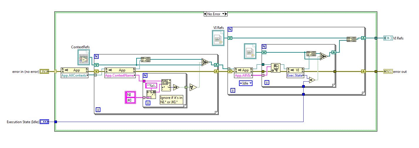

Basically my issue is this: I want to write a compiled application for my team to use to help us have a standardized tool to push VI help tip information. So I created a nice front panel, gave it memory storage via XML to remember info you might want to not have to type over and over again. I also gave it some formatting options, etc. Overall, a nice tool to speed up a repetitive task.
However, it runs great as a VI, but compiled does not work at all and I am sure many of you can see where this is going. I have cobbled together some snippets of code found on these boards to collect a list of references and names of all the VIs in memory that are not currently running. Then I use a ring control to parse which VI I want to target and then push the parsed and formatted help tip to that VI. But the reality is apparently that LabVIEW and a compiled application do not share the same memory allocation, because they are separate application instances.
Is there ANY way around this?
I tried one thing that seemed to make sense, but so far has resulted in the same thing. I tried to do a type def call by reference with an asynchronous call and a wait on asynchronous call function to return the reference list. However, even though this bit of code is still a VI and NOT part of the compiled code, it still somehow picks up the application instance of the owning app, and therefore does not see any of the open VIs in memory that LabVIEW controls.
Any help would be immense, as I am going nuts trying to figure this out!
Info: LabVIEW 2012.f3
I am also attaching a screen cap of the block diagram of the VI that collects the references.

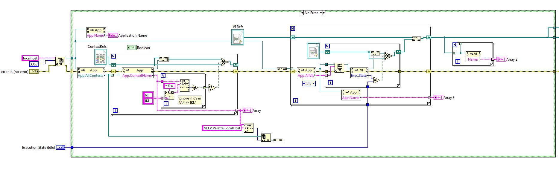

OK, I tried what nathand said to do. I added localhost as the string input, and added the default port of 3363 to the numerical input. This does not affect anything, except now it won't work even when not compiled. I hope I am not still doing something wrong, but I don't see what that could be. I will attach a screen grab of the block diagram for reference.
@roflk: OK, so the owning project has to be setup to use a VI server, if I understand you correctly. But how does this really effect anything? Even if the VI is part of a project, does that mean it is effectively invisible to the property node that calls all VIs in memory is we use the application reference node?

OK, I have determined the reason the list is now coming up blank. There is an error being propogated through the code due to my lack of proper error handling in this test. The error stems from trying to access the VI Server that is started by the TCP/IP settings. The error is as follows:
Property Node (arg 1) in Untitled 1
<APPEND>
Property Name: <b>Application:All VIs In Memory</b>
Error 1032 occurred at Property Node (arg 1) in Untitled 1
Possible reason(s):
LabVIEW:  VI Server access denied.
Property Name: Server:VI Access List
Seems like I have some access permission errors. Any ideas how to fix this?
