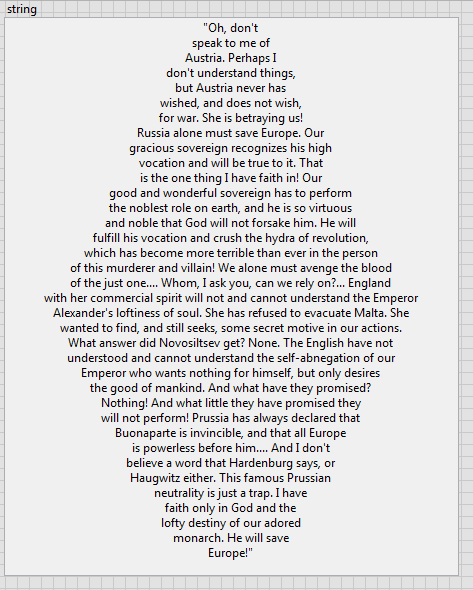

Word wrapping is a very interesting topic and good practice for many programming techniques.  My wrapper let's me do cool stuff like this:
Looks better when I run it through my hyphenator first, yet another interesting problem....
Of course for the MCL and its ilk the greedy algorithm (fancy name for the technique described in earlier posts) works just fine.
