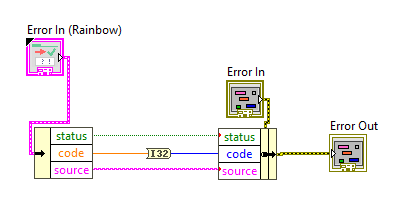

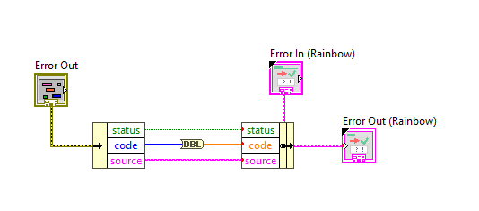

As a result, I wanted to write a sub-VI that essentially converts a Error Out (Silver) to an Error Out (Rainbow).  I have designed the following block diagram (attached), but I see coercion dots when I try and translate the values.  Why is this happening?  How can I fix this?
Convert Error Out (Silver) to Error Out (Rainbow)
Convert Error In (Rainbow) to Error Out (Silver)

It seems like RAFA didn't do a good job designing their rainbow controls.  Why would they make the error code number a floating point value rather than an integer?  It seems like it is not a double because when you use the To DBL bullet, it still leaves a coercion dot.
I don't see any reason by the boolean wire would leat to another coercion dot, or t the source string would either.  Unless perhaps they typedef'd those individual elements of their error cluster as well as their error cluster itself.

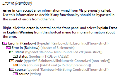

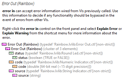

I believe the individual elements, and the error cluster are both type-defs.  Do you think that will be a problem?  I've attached both of the context help snippets.ContextHelpErrorIn.PNGContextHelpErrorOut.PNG

That's why you have all of the coercion dots.  It is going from a regular boolean to a typedef boolean.  Likewise for the string.  The error code as the extra step of actually being a double instead of an integer.  Since it is non-strict, it really makes no sense why they did it that way.
I would modify their controls so those individual elements are no longer typedef's, but just controls.  And change the code element to be an integer I32 instead of  double.  Once you do that, you should not have any problems.
