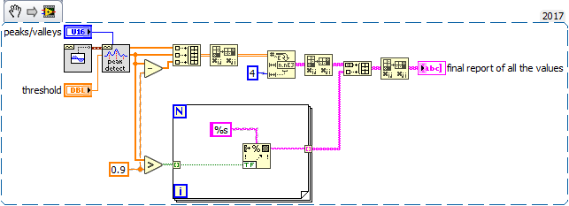

How can I convert array of Boolean values to array of text
I tried all the possible ways for converting the string to numeric datatype but it doesn't work even though if it works but still then there will be a problem by the other inputs given to build array.
 help me what should i do now and this is my last step in my project work.
thank you

Hope you are reading the data from file once and processing the read value, you are not acquiring any real time value, in that case why Loop is needed.
Not digging too much into the Functionality, i have Modified  the VI which will build as per your request to build in an array

Sir I have the LabVIEW version 14.0 and you shared the VI that is in 15.0 so can u share me the same file in 14.0.
And sir what you have said is absolutely correct i want to read the data for once and i used the loop since in the starting of the discussion for this topic in this page they tried by using this, so i tried in the same way.....

sir it is not giving the values of "format into string" in table the entire column of table is empty

can you share the File which you are accessing?

Yes sir i can give you and i collected that report from FREQUENCY SPECTRUM ANALYZER-18 and the report is related to current emissions of co-axial cable, and sir i cannot directly upload the .DAT file here so i converted that to notepad and i uploaded that here and for running that VI we can also use this text file

Hi kavya,
you should have found the problem on your own with a little debugging:
To append a column one need to transpose a 2D array (twice)…

It is not working sir and i want the output in text format that is (pass/fail) when the greater value it satisfies then it should load the pass output into the table like wise same with fail condition.
But when apply yours method it is simply giving the integer values in the table..

Sorry i missed to use transpose while building column, so it was appending in the last row.
Please Change as suggested by GerdW.
