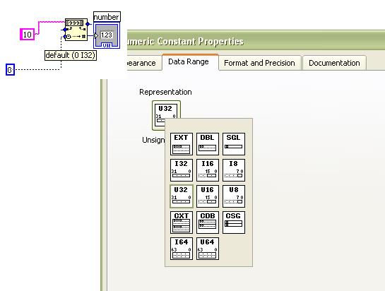

The default conversion is I32. Right click properties and choose the required conversion required.

I suspect the poster is looking for something like a "dynamic" Scan From String function. One where you enter the format string programmatically, and the outputs "automagically" change datatype at run-time. Such a beast, of course, does not exist. If this is the case, I would suggest using a polymorphic VI instead (one that would use a numeric constant to select the specific type of conversion so you'd get the "appropriate" datatype for the output).
