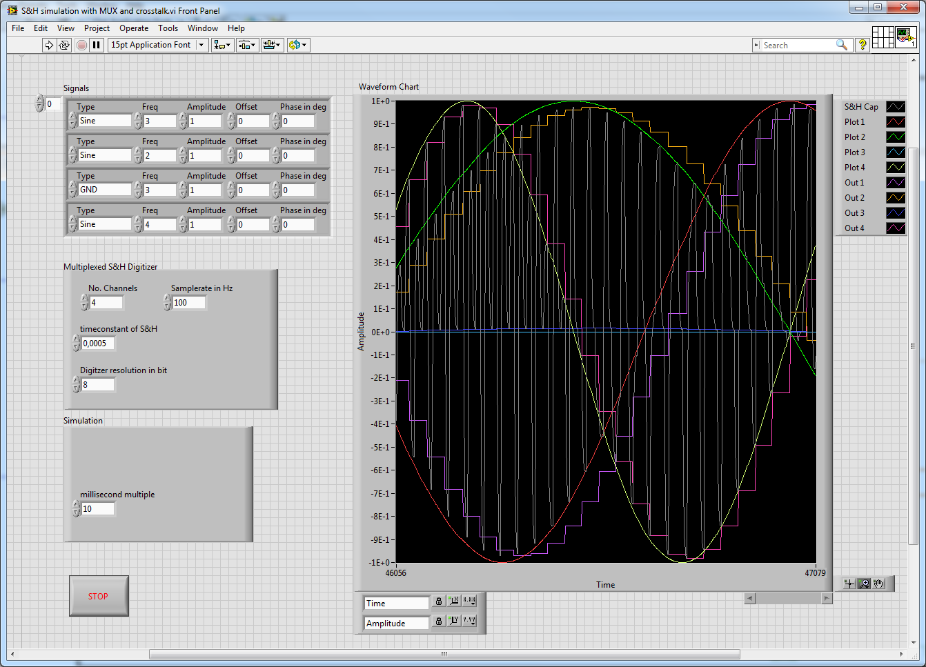

Out of curiosity and for educational reasons I build a simple Sample & Hold simulation for a multiplexed input including the effect of crosstalk due to the S&H cap.
Crosstalk can be seen in the pic on the dark blue Out 4 plot  🙂  and the per channel group delay ...
I was to lasy to add the bit resolution digitizer ....
Have fun 😄
