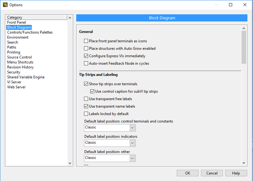

Click on control and right click uncheck view as icon.
Edit: by default if you want for all vis you can do the steps as in this https://zone.ni.com/reference/en-XX/help/371361H-01/lvhowto/display_terms_as_fp_icons/

After a fresh LV install the first thing I do to remove the check from the entry "Place front panel terminals as icons" (Tools -> Options...). I also turn off "autogrow", very annoying thing during dev 🙂
