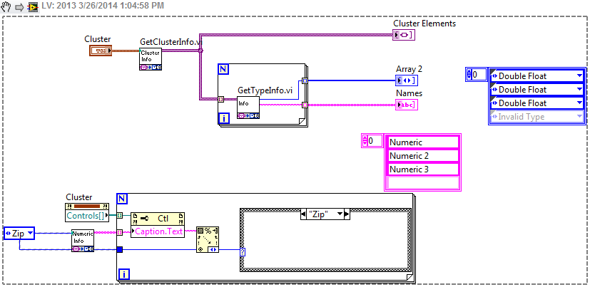

I really hate it when we say "You can't do that in LabVIEW"
The workaround is to not use the labels.  That's what Captions are for!
(Those vis you don't recognize are from Darren's Hidden Gems package)
