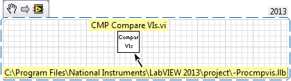

You could just run the vi
Ah I didn't read that right.  Hmm no terminals.  that is very sadSmiley Embarassed
Go next door to procmphier.llb and run that compare *(it also compares the file
Message 4 of 13
(6,299 Views)
Thanks Taki1999, that worked perfectly the first time!

By the way, I saw the LVCompare in the Shared folder, but I don't see it in the Functions palette to drop it on block diagram. I had to use only the PNG supplied above by Jeff.

The LVCompare is an executable in the shared folder.  And that VI Jeff pulled is not in the palettes.  You can use the command line to call it with the parameters to point to your VIs that need compared.
