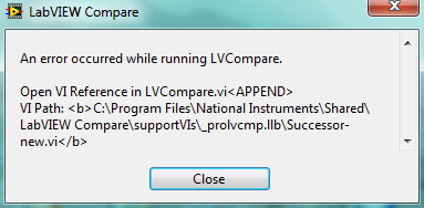

The problem with my original application of command was because I had VI names with spaces, as well as the folder names, so I just put them simply in root with simple names for the sake of experiment. And here is what I get ScreenShot014.png
where I was comparing "Successor-old.vi" with "Successor-new.vi" using a simple command on the command prompt in the LVCompare folder:
"LVCompare Successor-old.vi Successor-new.vi"

The command accepts spaces if the full paths are given within quotes "".
But nevertheless, different error appears.
