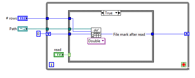

It seems like this should work:
Doesn't it?  "Read From Spreadsheet File" gives you the file mark after it's done reading.  Use that as your offset to select your next chunk of data.
